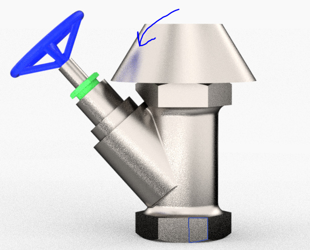

So, I have been creating a render for brochure. Client’s only 2 expectations are white background and things should be all shiny doesn’t matter if it looks realistic or not. So, I have trying this render but I get this reflection from left part which is again realistic. However, client doesn’t want that to reflect. I have highlighted that portion below. What is your workflow when dealing with mechanical components where all things shiny and glossy. Any inputs would be appreciated. image
One of the solution I did was putting a plane in between and matching that portion with reflection…but again that works well for one of the view.

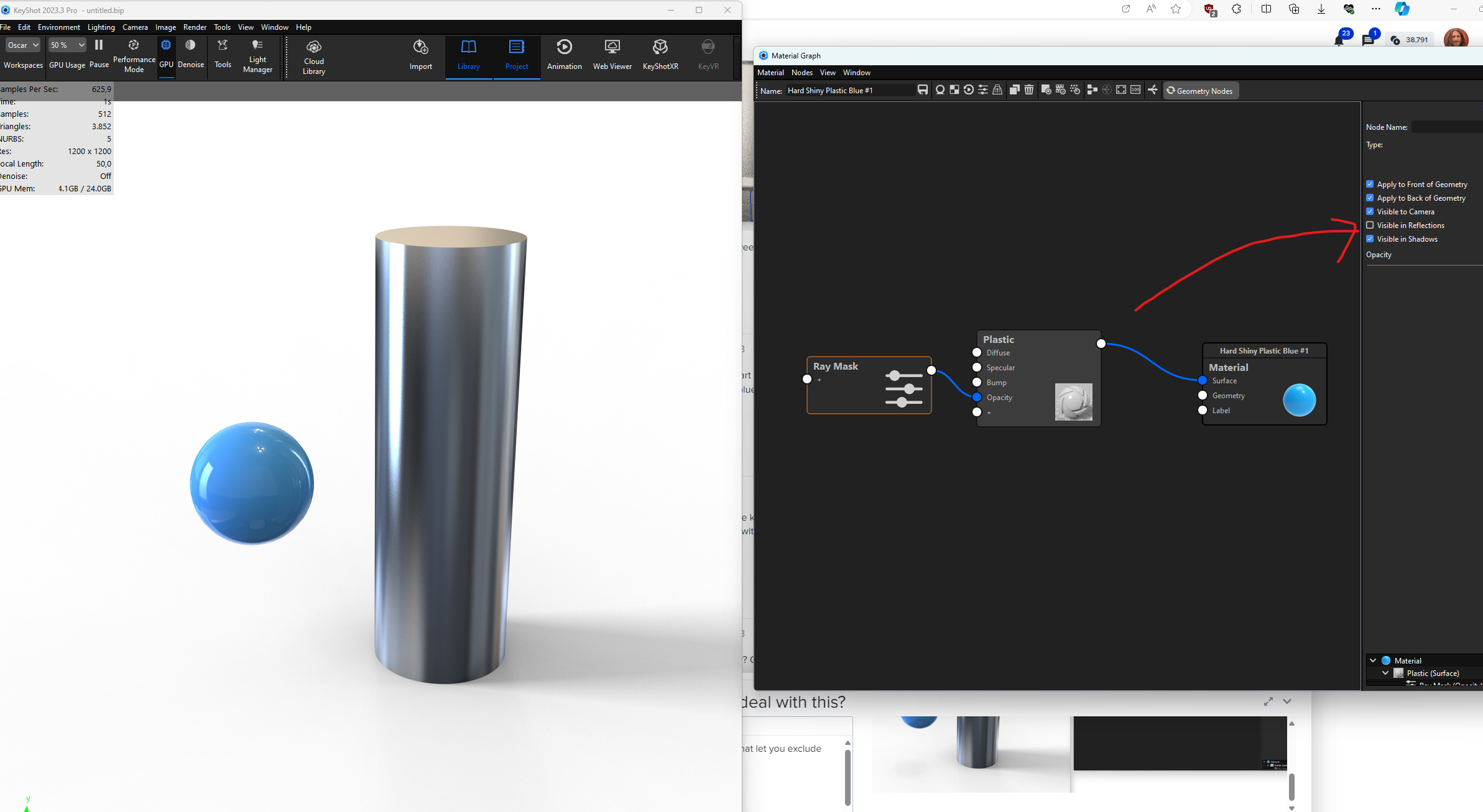

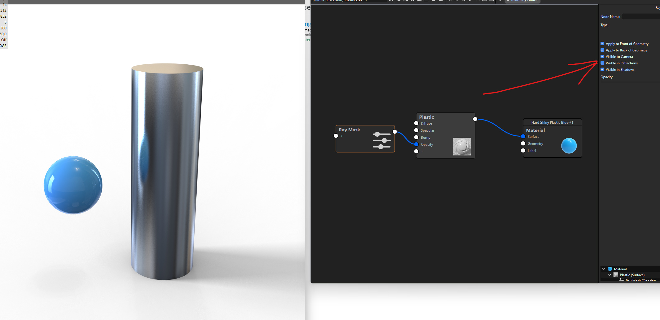

I think you could try to use a raymask node on the blue material, basically that let you exclude elements from reflection for example.
It’s a bit weird the manual still doesn’t mention RayMask since it’s there for a while and could be handy if clients want unrealistic renders :wink:
This is perfect! would include this one and I think it should work out…will be trying first thing tomorrow :smiley: Thank you!
